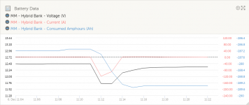

To note a point before showing graphs .... The Victron VRM system only samples the data (voltage, current, etc) once a minute. The coffee machine only runs for a couple of minutes so key points may not show up
The amount of Battery taken to make a cup of coffee was pretty small in the scheme of things - before it started, had 287.1Ah taken out the battery. After it had finished had 289.4Ah out the battery - so just 2.3Ah to make a cup of coffee. That is under 30Wh (typical 100Ah Lead battery is 1200Wh).
There was a significant drop in voltage due to the load - from 12.48V right down to 11.72V
According to the sampled data, the current peaked at 120A. At 120A with a voltage of 11.72V, that is over 1400W (I know I am back using P=V*A here!) so beyond the rating of the inverter and also higher than the quoted machine draw, which is interesting (and surprising).
This gets a touch more interesting with what I saw when looking at the Victron BMV, which showed during the time the machine was running, a current peak of 172A! That is a massive power draw of over 2000W for a supposed 1300W device and also to be delivered by a 1300W Inverter.

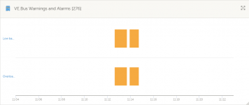

Unsurprisingly, The inverter reported an overload condition and also a low voltage condition (if the voltage dropped to 11.72V on a 120A current, it will have dropped a fair bit more on the 172A draw)
The reason there are two sets of overload and low voltage is the machine has to run twice - once for the milk for the cappachino and once for the coffee.
The Multiplus was still able to run the machine even at the overloaded power rating as it has a peak power of 3000W it can provide for 30 seconds, but it was clear that it didn't appreciate the load from the noises it made as the coffee machine did its pulsing.
