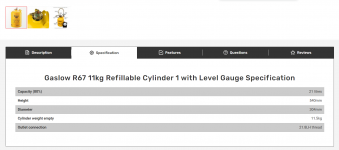

Gaslow 11Kg cylinder is 530mm high Kev.

Yeah I know Neil I did the sums and I'm 3mm short as I mentioned in the OP.

your first post says ypu have 547mm hight, thats 17mm abkvetop of a Gaslow bottle?
Indeed it does my learned friend.
But if you read on it also says the Gasit bottle is 550mm so as said 3mm short, then I started to look at the Gaslow bottles and I could squeeze a 11kg in height wise, but they are 19mm wider than the 285mm door aperture, so it would need a new door, more expense, so I decided to stick with the 6kg Gaslow, and a 6kg Calor as a back up until I can get the Gaslow refilled.
