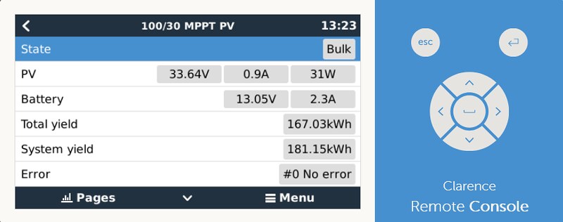

To be sure you have a MPPT controller if in doubt, you will really need to have a meter on the input and the output to see the values. I'm fortunate that I can log this and this screenshot shows the benefit of the MPPT over the PWM
MPPT-Instant
by David, on Flickr
The current going into the battery (2nd Row) is around 2.5x the current going into the controller (1st Row) as the excess voltage gets converted.
With a PWM that would get wasted.
