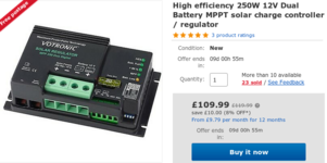

2 x 115w Monocrystalline panels supplied as a kit with upgraded Victron Smart Solar MPPT from Onboard Energy.
This one
So the controller will let you cable up either way (that would not be the case with many) and both ways will provide the same harvesting within measureable limits.
Parallel will give better mitigation against the effect of shading on a single panel.
Series will wake up the controller earlier and give a smaller voltage drop on the cabling - but both of those will give minimal benefit.
For a 2 panel system, I'd go parallel.
