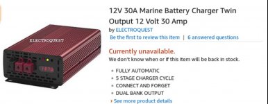

There are several battery maintainers that you can purchase and fit from the likes of Ablemail, vanbits, Sterling etc.
