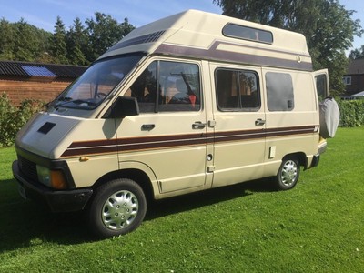

I think I mentioned a while back that I'd installed an inverter in our van to run our microwave and toaster and was in the process of installing a solar panel to keep the leisure batteries topped up.
We've just been off on our first trip since then and given the setup a proper test and it performed well using the microwave in the evening, watching telly all evening, plus diesel heater, then toaster in the morning. Ran like this for three days with no problems. And, it was pretty dull wet weather.
Happy days!

On our way home cruising up the A9 with Forrest running like a good'n there was a very expensive sounding bang, clatter, clatter, clatter from the engine and we coasted to a halt. Turning the engine over there is no compression. I rather suspect that the cam belt has gone.
The recovery home was a bit of a pantomime that I'll not go into here but at least Forrest is at a local garage now (well given where we live, relatively local). I dread to think what the repairs will cost.
But the inverter/solar panel setup works great :rolleyes:

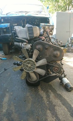

The garage has had a chance to have a look at the engine now and I'm afraid it is as feared it's terminal!
They're going to ring round their various contacts to see if they can source a second hand, perhaps crash damage, engine.
I briefly explored fully refurbished, but the company I contacted was charging nearly £3000 for a refurbished engine!
I just hope the garage can locate a replacement at a reasonable cost.
I've invested too much time and money into the habitation side of the vehicle to walk away but there is a limit to how much money I can throw at it!
Humph!
There's a few on eBay. Not sure of your act model/engine but have a look. There's also a bare engine 2.5d in Plymouth for sale at £950
Or buy a donor, drive it home then strip it...?
HTH ?
