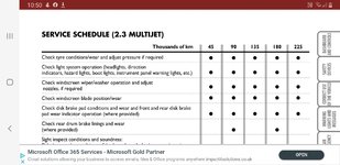

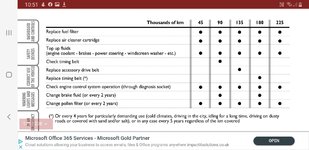

According to Owners Handbook it's 180,000 km or 4 years arduous with upper limit of 5 yearsScreenshot_20201014-105027_OfficeSuite.jpg
