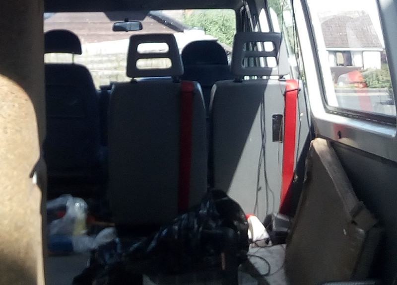

I couldn't see a shoulder mounting point. Are lab belts no longer legal on forward facing seats?
Yes, hard to see, but it looks substantial under the seat, but I see nothing for the shoulder strap to be secured to.
But there is nothing behind the backrest in further pictures David.
they go down the seat back and will anchor to the metal seat base, as El Radge suggests.
Same as the minibus seats that I took out in my Camper conversion. Each 3 point seatbelt secured to the seat base.
Not sure that would help in an accident, or if it is even legal.
why? and why?
How safe is down to how well the seat is secured to the floor. In the photo I posted, the seatbelts are secured to the seat. And there are thousands and thousands of seats like that, all of which are type approved and tested and have to pass PSA testing.
On the VW T5 I had before that LT, that had 3-point seatbelts secured to the seats as well.
I think on quite a few A-Class motorhomes the seatbelts for the cab seats are secured to the seats and not the van directly.
I would need to see one of these thousands of seat David.
All shoulder belts I have seen require a shoulder height rigid fixing. I've had four vans with a similar dinette forward-facing seat, and they had seriously strong framework.

I don't understand what point you are trying to make. The seats shown in the ebay advert have a diagonal belt. so do the ones in the photo I took of my own minibus.
Not my van for sale; no intention of buying it so not got that much interest in extending this discussion personally. I don't think there is an issue in the slightest, but if you think there is, so be it.
I have no idea how yours is contructed David, but the van in the link above has NOT got anu fastening for the upper part of the seat belt, how could that possibly restrain anyoen in a collision, it's belt will have ZERO tension, so it won't even act as a lap belt.
It maybe that is fastend to the structure below the seat, but I can't see how it would actually do anything to restrain a passenger, I'd not sit there.
