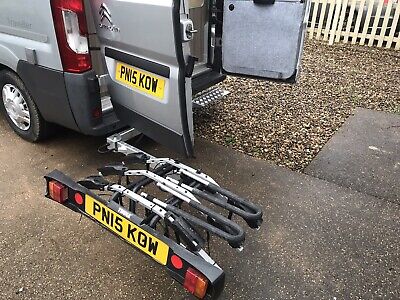

Atera Strada DL3. I have the DL2 on the back of a VW T5 and when tilted back the door catches the bike wheel. On the DL3 you can place the first bike on the middle rail, it also arcs back further than the DL2 so the (T5) door can be swung full open. Not cheap but worth every penny, no faffing round. You can fit the rack and 2 bikes on ready to go in less than 5 minutes. Example on a Ducato here

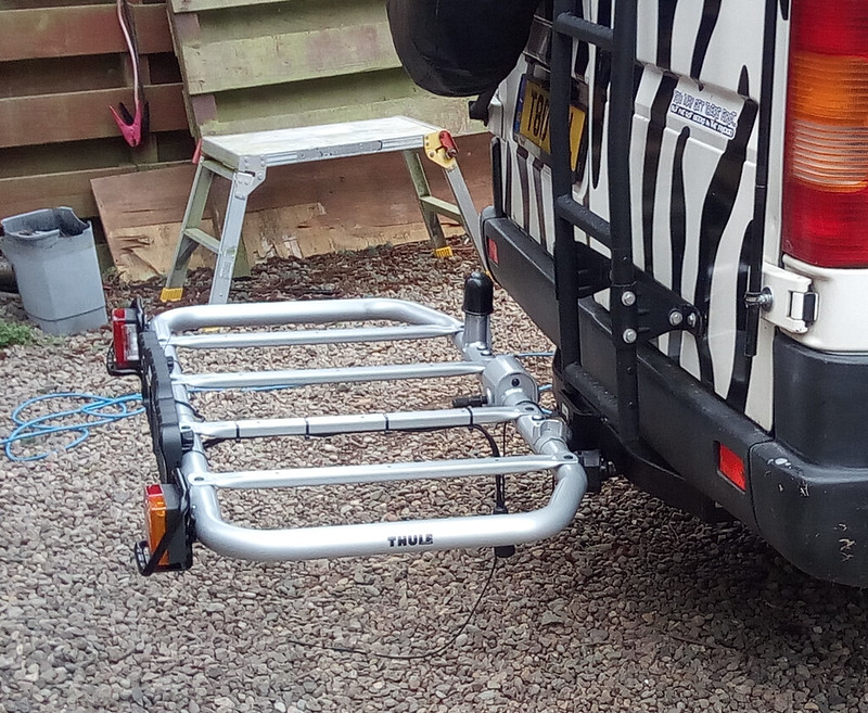

I fitted a Thule load carrier to my LT and just modified it to allow the right door to open while the carrier was still in place. I don't use it for bikes but the load on the right side - and bikes would have to be unloaded as well - but at least you would not need to disturb the carrier to do so.
Thule Carrier
by David, on Flickr
You would also need to have a support fitted to the door as the one on the rack must be removed (or could be adapted to clear with a bit of work)
I ended up with the Althea Strada three bike rack. On the Ducato I needed to drop the tow ball by 60mm and then the back doors open when the rack sleds back and down. It is a well made piece of kit and takes all th loads off the back doors.
Thanks, that looks like the solution. The transit is slightly narrower than the Ducato so should be ok.
