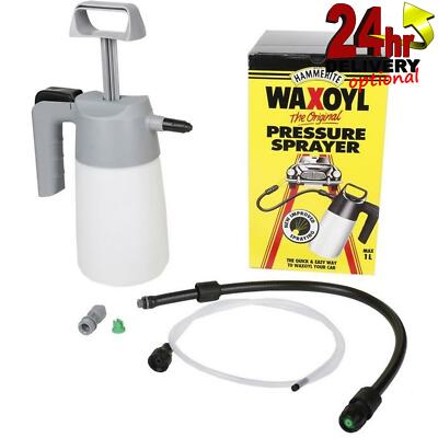

Waxoyl sprays on and can also go into the chassis via the multitude of holes.
I think 1 litre would be more than enough if you think how far a cup tea spreads if you knock one over.
Not sure if it includes the Waxoyl or not.

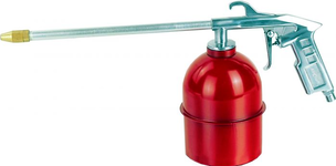

I mix waxol with a rust preventer and white spirit, I spray it into box sections and panels with a paraffin gun warming up the contents with a heat gun.
