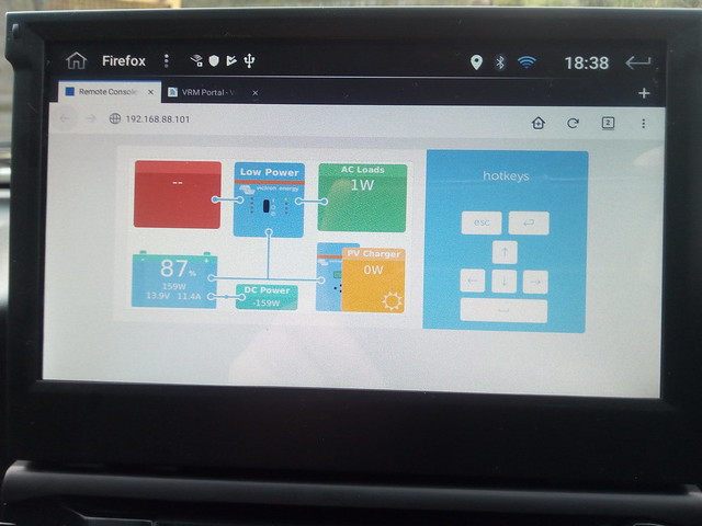

Having all the above available and built in ready to use makes the Venus GX much more of a systems monitor then the Pi I feel. The Venus GX is (IMO) a much better option than the CCGX as it is more capable and maybe half the price. I am happy to not have a little built-in screen (which I would very rarely use) and save a couple of hundred pounds.
I can use my in-dash head unit to do the same thing anyway ....
IMG_20190914_183818 by David, on Flickr
On the downside, Victron acknowlege the Wireless range on the Venus GX is very poor. I don't know if this is a real problem on a Motorhome though and maybe more so on some big yacht. I have it connect typically to a MiFi and it is fine, or smetimes use a little mini-router.
