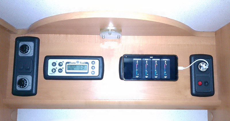

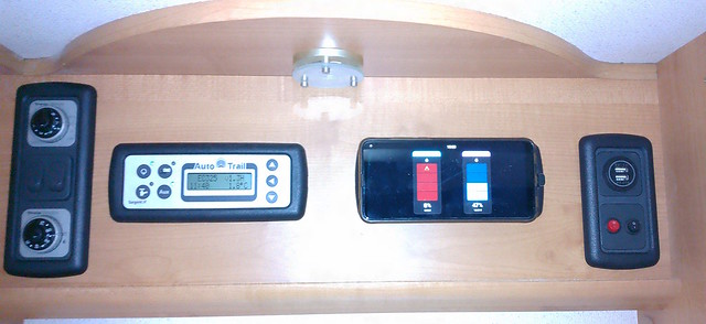

Right now here is a photo of my 'Kiosk' Display
Mobile Phone by David, on Flickr
Mounted using a couple of 3M Command Strips. Ideally I would fit to go with the two controllers above the door (A Sargent Control Panel and a Lights + Truma Heaters Controls), but there is just not enough space.

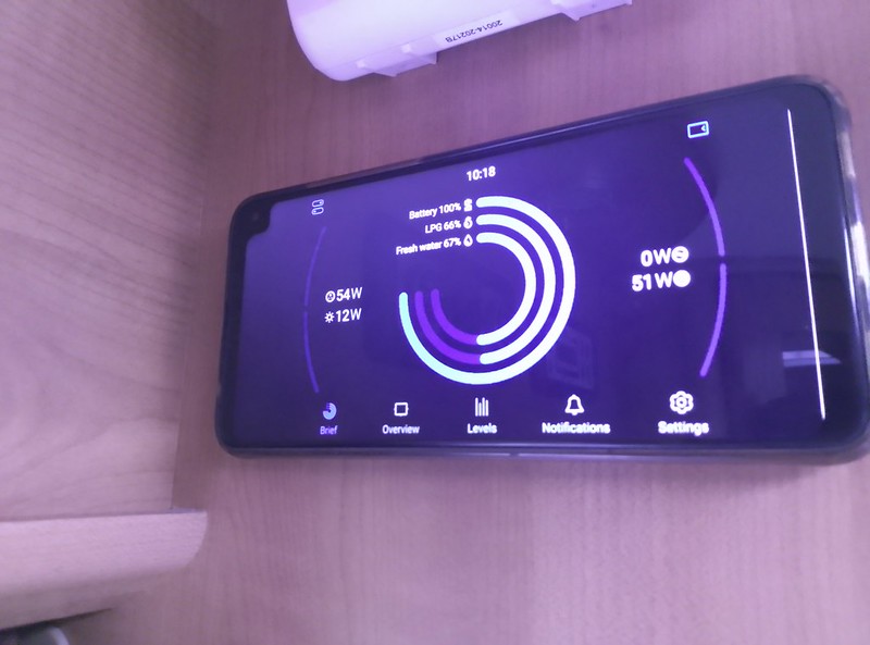

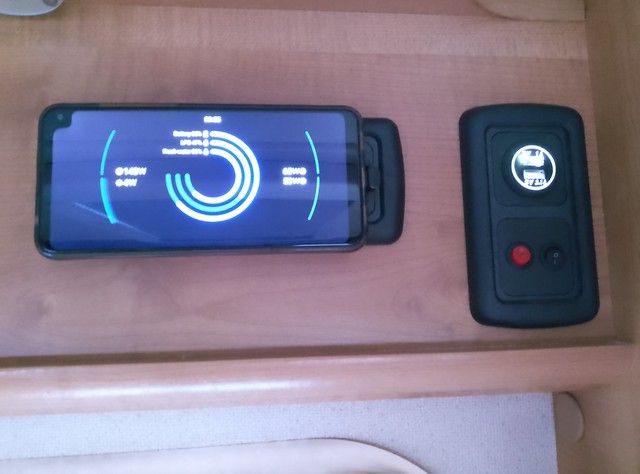

It is an old retired Android Mobile Phone with a screen size slightly larger than the Victron Touch50. Next are a couple of photos showing some of the information screens ...

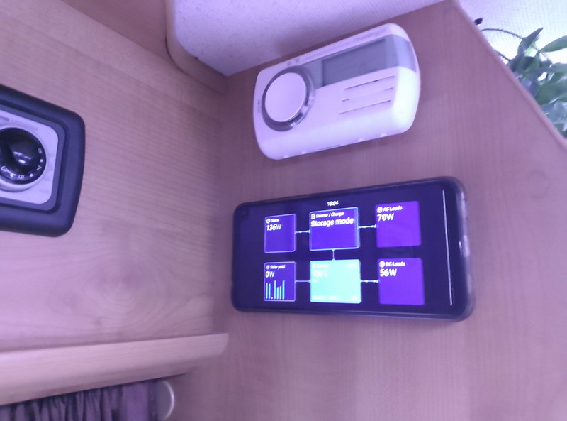

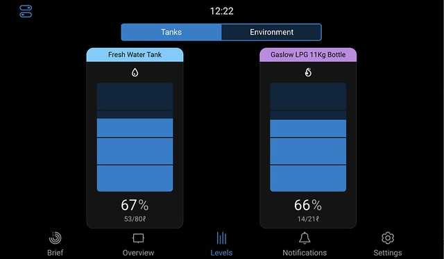

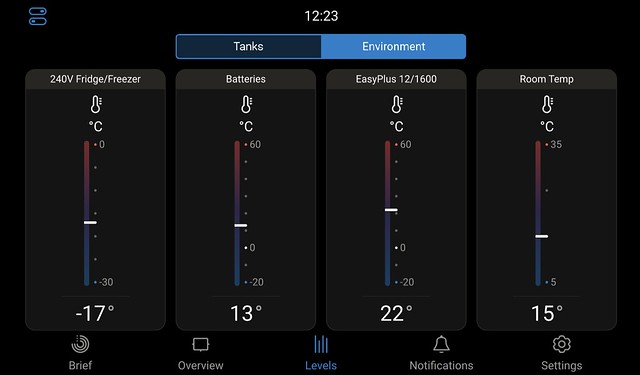

And some screenshots showing what other things can be seen on my own system ...
Levels - Tanks by David, on Flickr
Levels - Environment by David, on Flickr

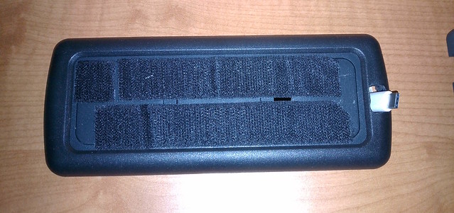

What is very handy in my setup is I have secured the gel case that the phone came with to the wall so I can also easily release the phone from the case and it becomes a truely portable control & display unit I can put down anywhere in the Motorhome, which is a great bonus.
