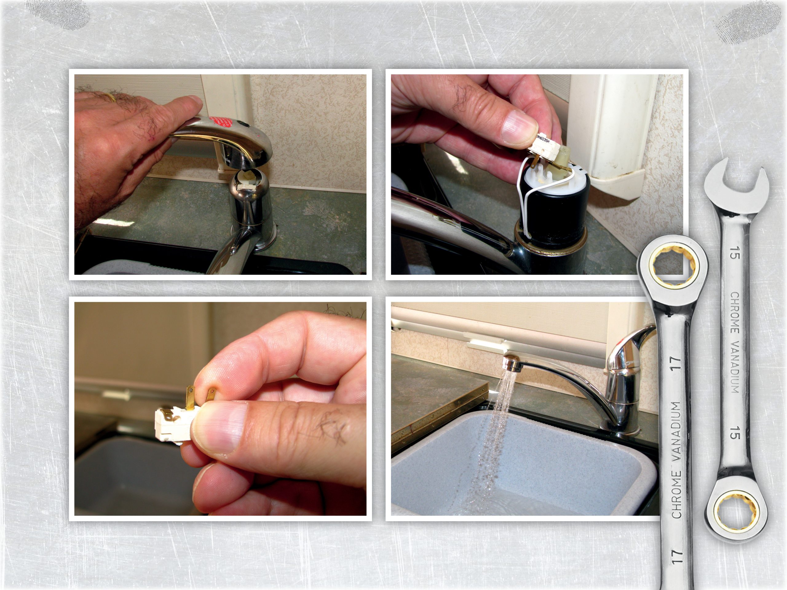

dodgy microswitch in the tap ?
I had what seems similar. by agitating/fiddling the tap on/off towards hot then cold it would switch off
It was the tap that was worn rather than the microswitch but a new tap with inbuilt switch was the preferred solution.
Look for the microswitch leads and connection..probably under the sink and try unplugging
You should hear a click when you open a tap (I use a stethoscope) so try all the taps/shower and toilet flush if it is electric to see if one of them doesn't click, if you look under the sink you should see two wires if it has a microswitch, easy to change just the switch if you can determine which one is at fault.
