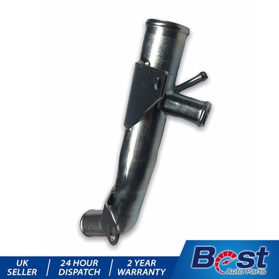

“Following on from the service and timing belt change, my garage had spotted a steel water cooling pipe running from the oil cooler had pink residue on it (antifreeze) suggesting a leak. They had ordered in a replacement and fitted it for free today. It helps that the owner is a motorhomer. They say they have replaced a few of these pipes on Fiats. My van is a 2015 2.3L multijet. Perhaps worth a look next time you are lying under your van, (as you do). It is easy to spot.
www.ebay.co.uk
FOR FIAT DUCATO WATER HOSE PIPE 504157800 68133357AA | eBay
504157800, 68133357AA. DUCATO (250_, 290_): 120 Multijet 2,3 D 07.2006 -. DUCATO (250_, 290_): 130 Multijet 2,3 D 06.2011 -. DUCATO Panelvan/Van (250_, 290_): 120 Multijet 2,3 D 07.2006 -. DUCATO Panelvan/Van (250_, 290_): 120 Multijet 2,3 D 4x4 03.2010 -.
www.ebay.co.uk
This is the type and shape of the pipe. The leaks seem to be at the joint of the smaller pipe (not the very small one) on the left”
