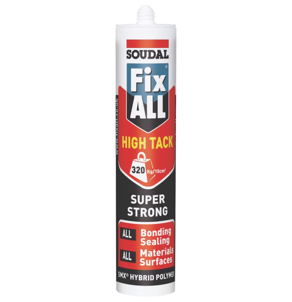

This is what I used still there after 8 yrs and 70K mls
