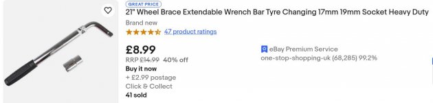

More than likley yes,you may get some in a breakers yard cheep.
Onr thing folks forget is a extendable bar to loosen nuts and tighten.wheel brace.jpg

Onr thing folks forget is a extendable bar to loosen nuts and tighten.View attachment 73934
Thanks , yes already got one of them. I'm still not 100% sure if the Bolts are the same & unable to take mine off at the mo as had Total Knee Replacement 🥺Having just spoke to the guy's that fitted my tyres he says 100% the Bolts will be fine 🙂
