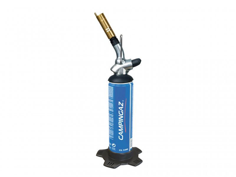

I have a couple of small welding/brazing jobs to tackle and wondered if this little kit would be up to doing them.
WE have a few of this type of thing in the garden and they are not made very well and all of them have bit where the tack weld has broken and I jsut want to keep them going so nothign major.
Too small a job really, and my garage is terrible damp it's die in there hence the gas welder but by the time I've added gas and oxy it kills the job anyway I think.

A £15 Butane torch, the screw on to a Butane cylinder type, will do what you need. I have one and have done a few small brazing and welding jobs with it.
I have one but it's pretty crap JIm, which do you have.
I have the same gas but with a bigger oxy bottle, boy have i done some welding over the years.car 1.jpgcar 2.jpgcar 8.jpgcar 16.jpgcar 17.jpgcar 19.jpgcar 9.jpg
I would have to go out and check. I have had it since Adam was a lad but it is just a generic one.
Just the correct type as you can't rely on descriptions these days Jim.
Cheers Jim, max flame 1800°c I'm going to B&Q tomorrow I'll see what they have or Screwfix too.
