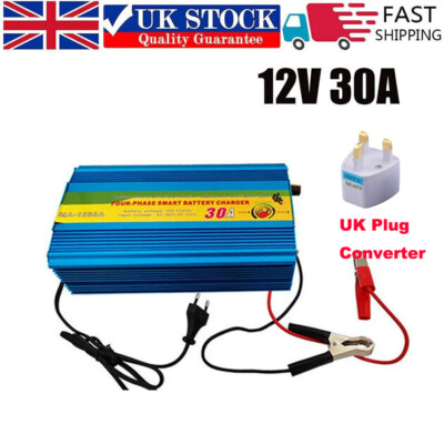

There's only a couple of connections (input and output) so if the connections are not the same on the latest unit then you could probably get a better unit at a cheaper price by going for a Victron charger. Alternatively this charger
Is cheap and seems to be excellent value for money, I've had one at home for a couple of years and it be works well, it doesn't give 30A as described and only 20A but that's probably enough, you could plug it into a 240 socket in the van and use the clips directly onto the leisure battery until you find a friend who knows what they are doing who can wire it into the original charger input and output cables.
All sorted now thanks.spliced a lidl twelve quid job in, working a treat now..rang magnums/olearys.and autosleepers all said the same.floating charger or summat.asked if lidl/aldi chargers ok.no problem they said.
