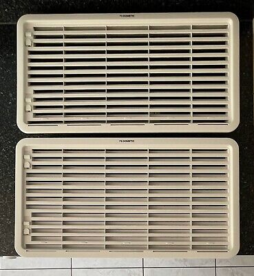

The problem is that many three-way fridges are very badly fitted and don't let the heat out easily.
My big 3 way a few vans back had the larger upper vent L300 I think and it did work whatever the weather but these older under the counter ones seem rubbish even if the sun isn't that hot with or without fans.
