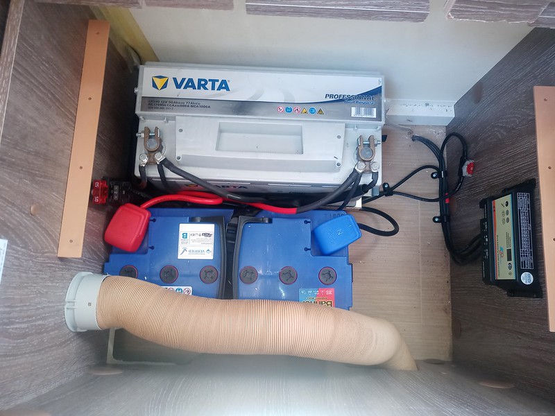

Mismatched/Unoptimised cabled 170Ah worth of basic Lead Acid Batteries at 10AM
Bursner BatBox - Original by David, on Flickr

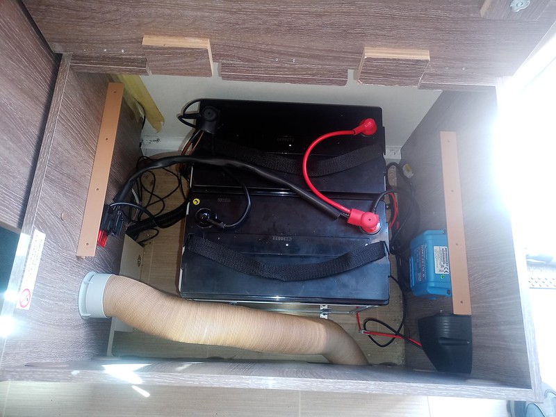

Matched and Optimized pair of 160Ah (so 320Ah worth) of Lead Carbon batteries at 1PM
Bustner BatBox - 2 x 160Ah by David, on Flickr
No significant changes made to the cabling (just remade terminals and connected in the correct manner) and no changes needed to the battery enclosure apart from repositioning the floor locking brackets
So easily more than doubled the usable capacity of the Motorhome Leisure Battery system with 320Ah of Lead Carbon loveliness at no more than the price of a single basic 100Ah Lithium, and with no additional changes demanded (unlike the Lithium).
What's not to like :)
