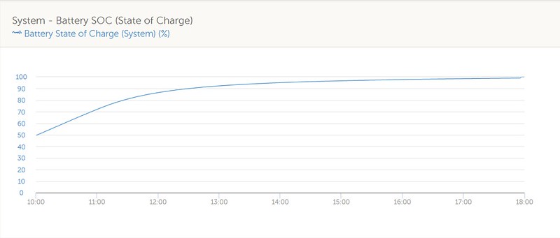

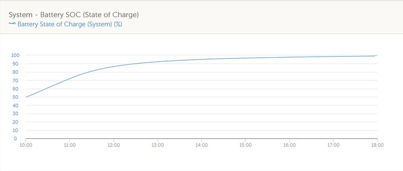

This is the chart of a 95A Mains Charger recharging the same bank from 50% to 100%.
This took 8 Hours. How long will a 20A, 30A or 40A charger take? This will be interesting to see :)
