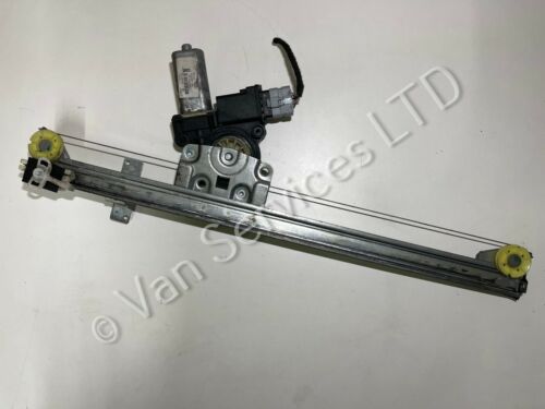

I suggest that you have a look at https://www.ebay.co.uk/itm/CITROEN-...-S-ELECTRIC-WINDOW-MOTOR-2007-11/293314674574 because it is easier to see where the mechanism has scraped in the photos.
Note that I know nothing about these window mechanisms: I just looked for a better picture
The piece in picture is only a part of the window mechanism, albeit an important one and the one that actually moves the glass.
The side runner guides can become dirty and restrict the glass.
There are a few different types of actuator, they fit to the door pivot side of the the glass, the one in picture uses rollers at each end for the bowden cable, if yours is like that possibly the roller shafts making the noise, other ones use an inner and outer cable and no rollers I'd suggest the only way to find out is to remove the door card and observe, the marks mentioned above in the rail are caused by the nylon slider moving along the channel, which should be silicone greased.
