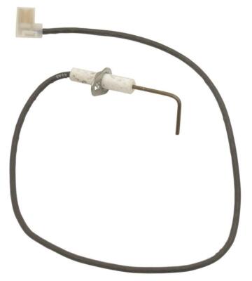

it could be this little bugger
As green grass says it could be this I had the same problem started as an intermittent fault but then it became a permanent fault I changed this pictured above and it now works fine around £60 eBay check you get the correct one if it is this as there are a couple of variations.
