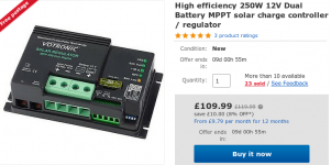

Dont understand why folk want thes sys in vans, better to use a votronic regulator by its self.solar duel a.png

The Votronic sends up to 1amp to the starter battery si trickle feed rather than charger. It still depends on how much solar you get so you could have full hab battery and nothing going to starter. I have one and it has helped me a lot but if I am stood a few days with no solar the parasitic load still means I could have a flat starter battery.

The Votronic is a pretty poor Vehicle Battery trickle charger with its very low 1A MAXIMUM feed. And bear in mind it is only active when you have solar and in storage in Winter that could be as little as 4 or 5 hours. So that is 1A for say 4 hours and nothing for the other 20 hours of the day. But the residual charge does not stop when the sun goes in. It is there 24/7 and the votronic is doing nothing for you for 5/6ths of the time, and not a lot for the remaing 1/6th. (can you tell I am not a big fan :) )
For a litle more than the cost of the Votronic you can buy a Victron of the same rating AND a battery maintainer which will provide far more flexibility.

I am a fan of the Votronic but wanted to point out its shortcomings lol I got a noticeable difference after fitting mine but as said it relies on sunshine which we don’t get all the time in the U.K. probably if someone has a very low residual loss it may be the answer but it can’t keep mine up for long.
As an mppt controller I rate it above my Victron 100/20 but that is a different discussion 😁
The link switch works for me as i can bypass the 1ah to the full monty with votronic in the few weeks the sun is low and dark days.
