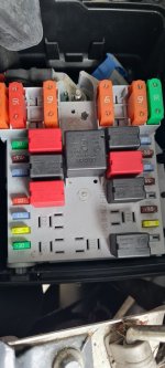

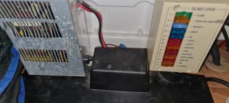

Disabling the relay will solve the problem. Finding the relay depends on the system installed in the van. If you can post some pictures of your main electrical system, I can work it through with you.
Thank you, that's a very kind offer. Have attached both under bonnet relay box and habitation box.
