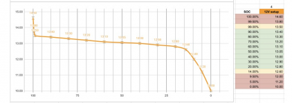

I would like to hear the solid technical reasons why you say this is so. Lifepo4 can be charged with any voltage up to 14.6, and it matters not if any legacy charger can only supply 13.8 or anything less than that. If you look at the typical charge and discharge characteristics of 12v Lifepo4 any charge voltage over 13.5 will result in a near full charge - the last 2% is irrelevant in most applications. And in any event, the BMS in a lithium battery will protect it if the charge/discharge parameters are exceeded.

So why are you swimming against this particular tide? What is your qualification and reasoning for doing so? I accept you are a grand daddy of this forum and give out great advice, and I don't want to knock that, I just want to know the technical reasons.
Lots of LFPs will disconnect and error if the charge voltage is too high. 14.6V is absolutely too high and will cause an error in the majority of cases.
I don't agree with your statement about only needing 13.5v to virtually fully charge an LFP battery.
The chart you posted is a Discharge graph. Charging characteristics are not the same as discharging ones.
