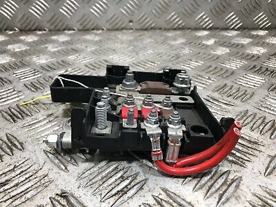

I was travelling through France in a Elddis motorhome on a Peugeot Boxer chassis and pulled into a motorway services. When I got back to the van the ignition was dead. After being towed off, I was jump started and drove to a Peugeot Garage who investigated and fitted a new battery. The next day as I drove to a campsite near my ferry port, I stopped in a lay-by to check my route and once again the dashboard was dead and there was no ignition. I then had to be towed to depot and jump started. The following morning I drove to another Peugeot dealers. They investigated the issue and said there was no problem. On the day of my ferry, I stopped at a supermarket and everything was dead when I tried to start it. After 4 hours I found someone to jump start me then drove straight to the ferry and left the engine running for 2 hours so I could board.
I got the motorhome home then took it to my home garage who immediately worked out the problem. THE BATTERY CONTROL UNIT, ATTACHED TO THE POSITIVE TERMINAL WAS INTERMITTENTLY STOPPING THE BATTERY FROM STARTING.
Because the French main dealers were incompetent and because the French police insist that you have to use their recovery companies, even if you have breakdown insurance, it was an expensive experience. Approximately 500 euros for recovery and 300 plus euros for diagnostics and a new battery I didn't need. (The old one was less than 2 years old.)

He calls it a battery control unit, but surely it is only a battery and ancillaries connection point, so would only need cleaning up and putting back on if the fuses are ok.
I looked them up and it doesn't mention control.
You’re right that’s it’s not a control unit. It’s effectively an extension to the battery’s positive terminal with a number of heavy duty fuses built in.
It gives options for adding multiple additional accessories.
In my towbar fitting days, we used it often for the supply of 12S Caravan Electrics and/or the feed for bypass relays….
Corrosion is a pain. Kev, you and I are always on the ball when it comes to doing preventative maintenance and this connection is prone to corroding hidden away as it is. I suppose I tend to be fettling stuff all the time and a smear of ‘no ride’ or similar on terminals always seems a matter of course. But to those who don’t get down and dirty with the spanners aren’t going to know about things - but a professional garage should be knowledgeable enough to know to clean up connections when replacing batteries. This is why I have a vehement distrust of anyone doing work for me.

Having it hidden under the floor but exposed to the elements seems a bit silly and it's a pain in the butt to get at and for most a daunting thing to mess with.
The thing is clearly corroded! Some light sandpaper on the battery terminals would be a good start, along with the battery clamps.
The whole thing is dry as a bone. Any self-respecting service station should have been lubricating it….

No service would include lifting a carpet and then removing the four bolts in the cover unless you specified it, and then you'd have to lift it yourself to see if they had done it, not sure if grease is a good thing on terminals, Vaseline is what I would have used.
