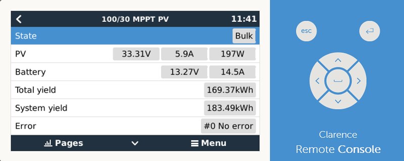

This is my info, with the same Victron Controller type as you have and showing the same type of info, just in a different system
MPPT-Instant by David, on Flickr
You see the total power in Watts (197W) - this is the same as multiplying the Voltage x the Current
It also show the Total Yield in kWh (169.37kW) - this is what the Controller has put into the Battery over time; And the System Yield (183.49kW) - this is what the Panels have harvested over the same time. If you divide Total Yield by System Yield here, you get 92.3% Efficiency in the conversion process over the overall installation time (the efficiency varies on size of harvest - my 'instant' efficiency in the screen shot above is actually over 97%)
Hopefully all the above makes sense?!
