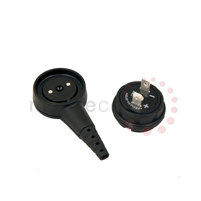

If you want a very neat connector that is totally waterproof, the MagCode ones are very good, but they are expensive.
Rated at 15A (There is a 30A version as well I think)
I use one of these for an awning light.
