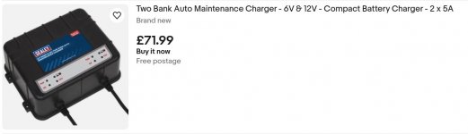

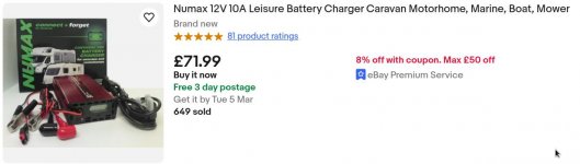

Ebay is full of them, some will charge 2 as they have 2 outlets, or you can rig up a pos jumper wire to link all batts up.chargers.jpgmantanence chrager.jpgnewmax.jpgsmart ch.jpg

run a fused wire or one with a switch between hab and starter battery, so the charger will charge them all if connected to any of them, my numax is fixed within the van and works of the hookup plug, i have a swirch to connect them all up for charging.
