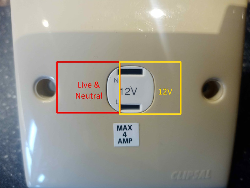

Ladies and Gentlemen, the Clipsal Socket. I think this dates from the 1990's or probably earlier and found in British Motorhomes into the 2000's.
clipsal by David, on Flickr

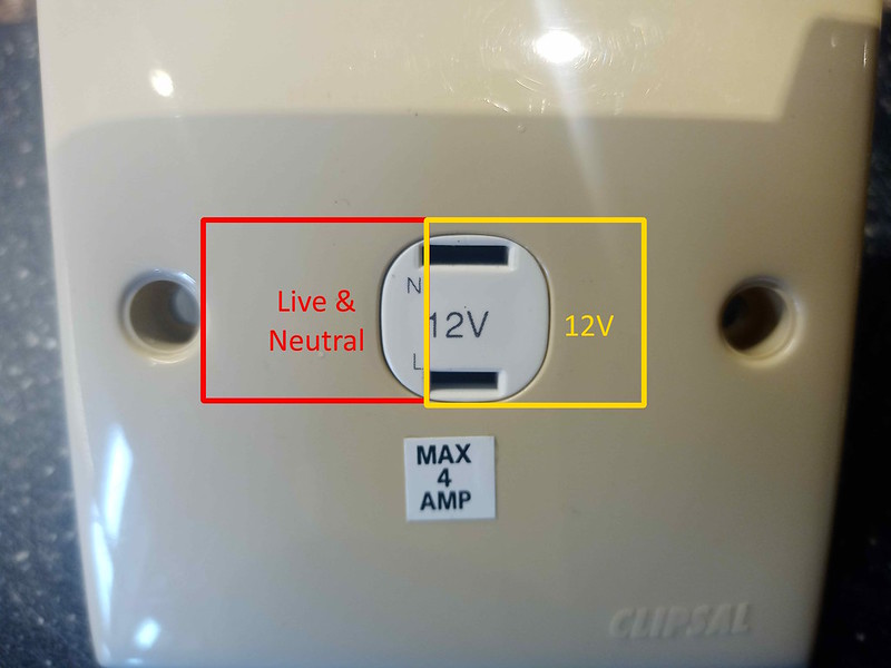

The ideal socket for 12V DC. No, for 240V AC. No, for 120V AC. What the hell is it for??
It is for AC Only

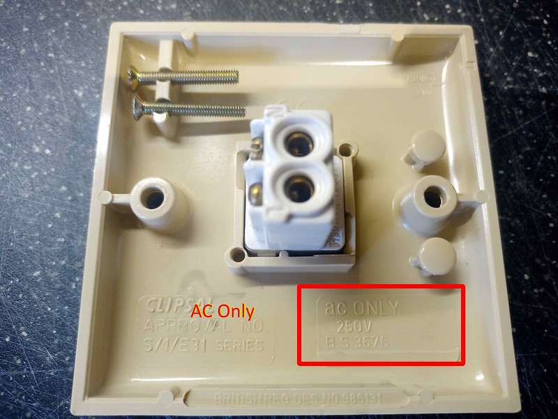

clipsal 1 by David, on Flickr

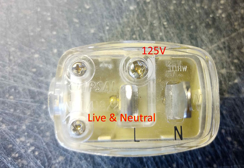

But the Plug is rated for upto 125V only. So not much use in UK & Europe.
clipsal 2 by David, on Flickr
The label on the front is a bit schizophrenic. Labelled L & N, which are AC terms only, but also labeled 12V, which will be for DC surely?
clipsal 3 by David, on Flickr

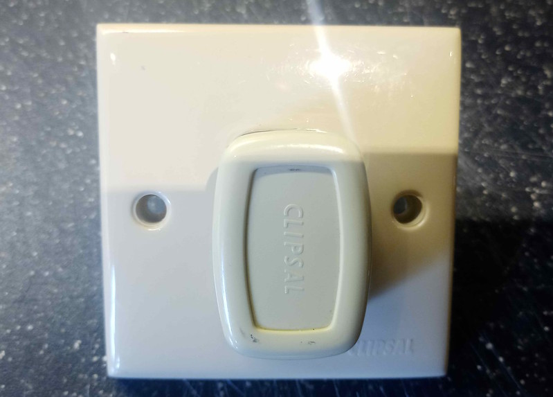

and 4A maximum? that is a very low current capability for a 12V DC socket, especially considering the cable terminals and the prongs are pretty substantial and I would think could handle a lot more than 50W of power.
Now it is of course a 12V outlet, but with the "AC" labeling & 125V/250V markings, plus the use of L and N instead of +VE & -VE, I could easily imagine someone wiring this up to an AC circuit thinking it is a special Motorhome or Caravan Mains Socket style.
Then someone plugs in their 12V TV or whatever ..... OPPS!

It really is superior in the security of the plug :) I think the industry moving generally to the "cigarette lighter" style connector was a bad idea :( Those are so variable both on the sockets and the plugs, it is a lottery if you end up with a good combo!
If those Clipsal sockets were available on a CBE Mount, I would be inclined to swap my 12V "Cigarette" Sockets for them.
but it also has L & N and "AC Only" written on it, doesn't it?
So who says 12V takes precedence?
And THAT is the point I am making :D
12v displayed prominently on the front ...
Anything else is moulded in inside where almost no one is going to bother looking
L and N mean little to a lot of folks especially with an odd looking 2 pin plug
I'm still thinking ...not much hope
Sorry ... you are missing the point....
on the BACK it says "AC Only" and L & N. imagine someone who is new to the process (and there are loads of folk like that who have little experience) INSTALLING this socket and because it say "AC Only" etc, he thinks it is a Main Socket and wires up to the AC circuitry
Then ... you get someone else using the van and sees "12V" on the front and wires up a 12V device to the plug and plugs it in.... BOOM!
No, YOU wouldn't do it. No, I wouldn't do it. But the point is WHY is a device being made that has such poor labelling and could for the inexperienced person be potentially dangerous as it leads them with the wrong info.

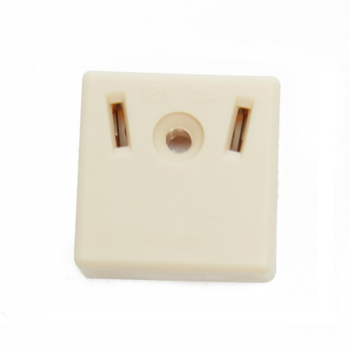

I remember the other 2 pin ones as well, like this:
