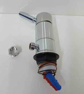

Right, I’m a tad baffled with is setup, I have removed the tails for hot and cold, see red and black insulating tape, the other blue pipe attached to the flexible shower type hose both go into the tap. I have attached pic of underside of sink, I’ll need to have a tool made up, and as marshman has stated, it is a mare to get at.
Below the now removed tails you can see where it T’s off for the shower, I’m going to see if I can blank the hose where I have removed H & C tails. I’ll use shower to fill sink when required. I think the cartridge within tap body maybe knackered?

Similar to my shower tap Terry you need a deep 10 or 11mm socket then it is much like a domestic one, with a central bolt and C shaped clamp.
Mine leaked from an O ring in the tap body, the pushing and pulling of the shower hose caused the problem, the intention was to have a separate shower and basin tap to stop it happening again.
I was lucky with ours as it has a swing wall, and once that was out of the way I could take the whole plastic corner panel out and invert it once I had split the tails, it did rip the paper off the walls of course as some clown had sealed it with bathroom sealant to the wall, making it into a massive redecorating job, I had to use car paint to make the wall waterproof again, it looks untouched now as I got a good match to the ripped off paper, sorry no pictures of it but yours looks to be a normal corner basin.

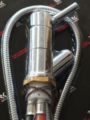

Think this could be your tap Terry. It seems it isn’t held by a crescent shaped clamp under the sink but is a big hexagon nut. Can’t see how the gubbins can be accessed from the top.
Cheers
H
It looks to be the right one, but you would struggle to put a nut on it due to the wires and pipes, shame it doesn't show more detail.
Cheers for this Winks, this is the tap, and held in place as you described. And I now see why there is the shower type feature, which is never used, nor will it. Some price though!! Although maybe I can fix when I get home, I don’t have the tools here.
