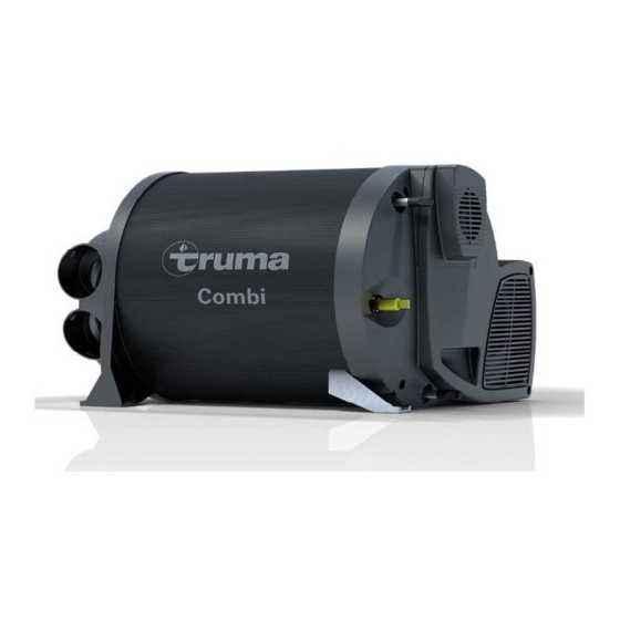

Hi, I have a Trumatic Truma C Combi boiler & blown heating on my 2008 Hymer. The water heating works but when I switch to heating it clicks in for a few seconds then the red light comes on. On inspection the fan doesn't start (but I can move it freely by hand). Could this be because I'm parked on a steeply inclined drive? I know the gas fridge doesn't work on a slope so wonder if heating is similar?
Thanks
I'm on gas as this is a gas only truma, but I am on ehu so this isn't a battery fault and this is an analogue system so no LED display

It appears the room sensor is a good place to start. Disconnect the wire off the back of it, little black button looking thing somewhere on a wall, and if the heater runs flat out and no red light appears that is the culprit.

You should still get some info via the led's on the PCB in terms of pattern of flashes .....

Could it be your lesure battery is low .? I doubt an incline would affect heater ,check your cable is connected properly or blown the fuse ,
