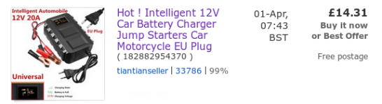

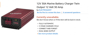

I use a numax smart charger at 10ah output, i have a switch which connects hab and starter batteries if required during deep winter.
There are others much cheaper on ebay these days.12v 20a charger.pngnumax duel.png
