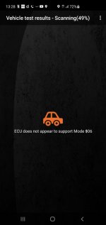

I dug this out just now, bought it ages ago and Liz tidied it away 🙄🙄
I just need to figure it out before starting if I can.

I just plugged in the OBD2 reader it showed no stored faults and it found nothing, I'd expect it to pickup glow plugs though.
