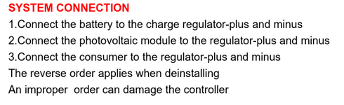

Connecting the panel to the regulator before the batteries bu--ers them up, same as running a car or m bike with a dead or no battery wrecks the regulator and can blow diodes in a bridge rectifier, are you clear on this now.makes a difference compared to doing it the other way round? wouldn't know as I only do it the right way round![]()
