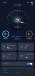

Got all the rest of it. Left the meter in the workshop.We know of one case where a Fogstar decided to turn itself off in the middle of the owner taking a shower!
Was quite flummoxing and three or four people standing around the van trying to work out why the system complained of low voltage whenever any load (such as a couple of LED lights) was put on.
This is logical, but actually incorrect.
Continuing from the waffle above, we were checking the voltages with a multimeter and they all read ok with lights off, including on the battery terminals. But what had happened was the Fogstar battery had switched off, and the voltage being read on the battery terminals was actually being provided by the Victron MPPT Solar Controller. To check the battery voltage accurately, you need to remove either the -ve or the +ve connection on the battery, and to read the voltage even approximately you need to turn off all chargers.
Someone (not me, I think) had the bright idea of going into the Fogstar App and found the disharge option was toggled off! Turned back on and all good again
No idea how it got turned off - As mentioned, the owner was in the shower when the power failed so wasn't him. Was it a glitch? was it a naughty camper playing games? (there is no password/pin protection in the Fogstar App so ANYONE with the app can go into any battery they find and mess around with the settingsThat needs fixing, Fogstar!), or was it someone with their own Fogstar battery turning it off but logging onto the wrong one accidently?
