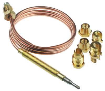

Sounds to me like problems with the flame failure devices (FFDs) for those rings. If you look closely at each ring, you should see a probe that the flame 'washes' over when the ring is lit. Sometimes the clamp holding the FFD can fail or the FFD otherwise be moved so that it no longer sits in the flame. If the flame 'washes' over the FFD, then it's likely the FFD itself is now duff. Hopefully, that will help you diagnose further but I'm not a specialist, so no guarantees...
a quick check on positioning of the ffd is if it lights with a kettle or saucepan on the fret directing the heat down ! if so it is a case of repositioning it if not then as above it’s duff

It is a simple job to replace the ffd. You can get universal ones off flebay quite cheaply.
