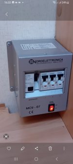

The switch can define what happens when you toggle it, but it is entirely up to you to decide why and when.I've had a look but can only see a facility to use cab battery when hab is low, which isnt really a wise idea.
Can't see anything to swop charge to cab battery from hab battery.
Why not just start the engine before winding the bed up or down?The bed is powered by the M/Home cabling which is wired to the Leisure Battery, and we don't have the space or payload to cart another 28Kg of standby battery for Mr Justin Case.
The change over from leisure battery to starter battery doesn't JUST govern which battery is being used for the habitation, it ALSO governs which battery gets charged from EHU too. Therefore if you switch to 'Vehicle, cab or starter ' and plug in EHU you'll charge the starter battery instead of the leisure battery.I've had a look but can only see a facility to use cab battery when hab is low, which isnt really a wise idea.
I certainly hope not.The switch can define what happens when you toggle it, but it is entirely up to you to decide why and when.
If you want to switch to using and charging the starter battery, do it. Nobody will die.

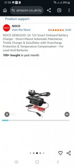

You learn something new every dayThat's not true for the Nordelettronica chargers, Stratto, they are bona fide chargers with adjustable absorbtion and float voltages.
