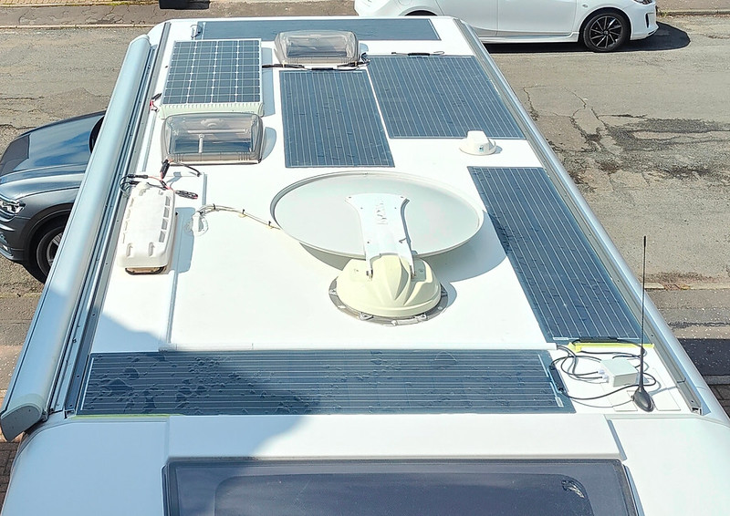

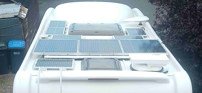

I've posted this photo a couple of times on different threads, but it might be of interest and relevance to your comment above?
On my Motorhome, the front part is a dome so nothing can be fitted on it (most vans with a overcab lump have an angled but flat section that can be used). Behind that I have a TV Aerial, a large skylight and 2 more smaller vents and a satellite dish, but choosing my panels carefully, I have covered all flat parts with PV Panels.
Monty-Roof
by David, on Flickr
Since I did this, Photonic Universe has introduced a range of solar panels that are narrow and ultra-narrow and I selected various sized panels from that range to fill this Malibu roof with as much solar as possible while still accomodating a rather large satellite dish as well the roof skylights and fridge & heater vent.
Malibu - Front
by David, on Flickr
Both methods work well. Using the semi-flexible panel option gives a much neater option on a roof than the glass panels and for sure is the better option for a motorhome like that. On my Autotrail the side walls extend quite a few inches up from the roof so the multitude of solar panels cannot be seen unless you are above the van so in the case of a Motorhome like that, the appearance is not affected at all.
(Of course, to many, function is all and the asthetics are not a factor, but it is nice to have a smart looking solution IMO).
Monty-Roof by David, on Flickr
Malibu - Front by David, on Flickr
That's interesting, I will take a look at the Photonic Universe SPs. Thanks for the tip.
