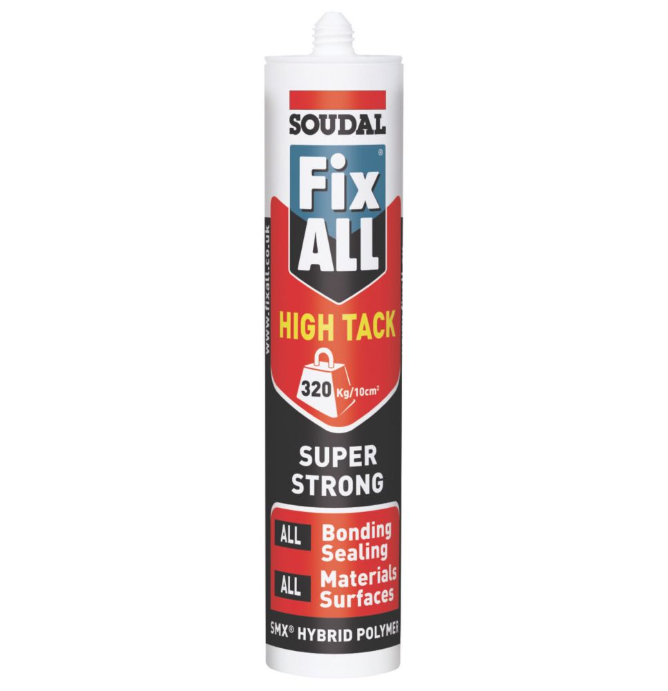

Solar panels and large Maxview sat dish both been stuck down with screwfix fixal 8 yrs still there

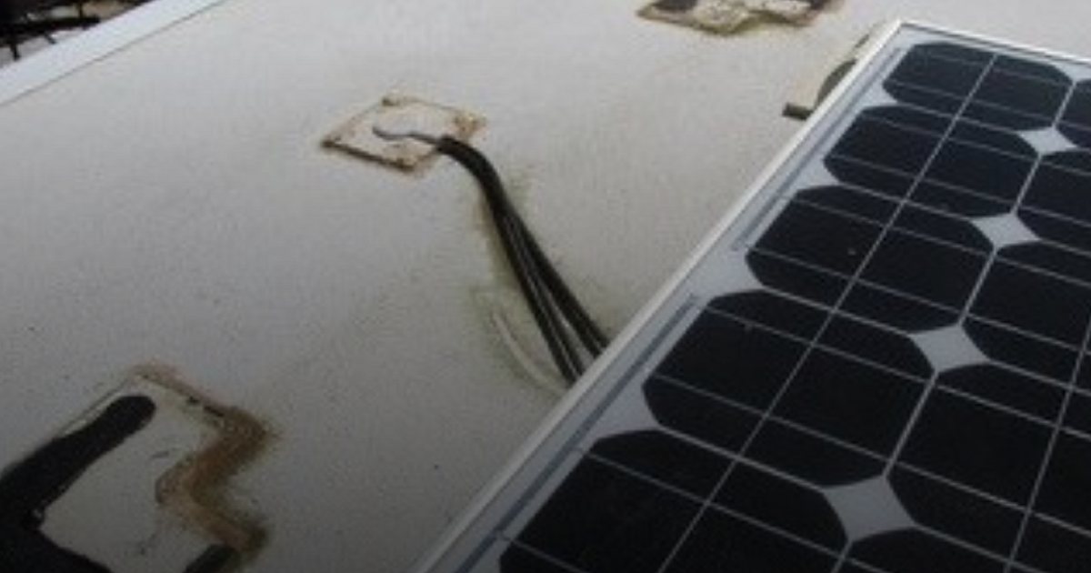

Yes and no! Panel was fitted/glued by MH company. It is checked at yearly service. 3 yrs later it came away whilst travelling. Never found the main panel whist collecting the debris. MH company fitted new smaller panel in different place as most of the original glued parts were still intact and would cause damage if tried to remove them. Guessing it was deliberately taken off! Van is high, I am short with gammy leg, panel not visible without a climb. Solution is to get a new van though I am rather attached to 'Vicky' but never want to go through that experience again. Pam
