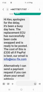

I messaged my mate last night after posting but he has not replied yet I'll message him again.
It was the ECU doctor, he shall look and see if he has the number when he returns home.
