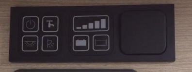

In a 2020 Motorhome I would think you have some kind of Control Panel that shows the voltage of the batteries and also probably the current used?
Check the voltage of each battery on the display. Then start the engine and check the voltages again. If they have both gone up, the alternator will be charging the battery. If you have a current display, you can get an idea what the charge rate is.

My control panel has lights only and a sort of percentage indicator of rate of charge (I think). Instructions are pretty useless -
but it has a connection for a second battery.

I was think more about the Motorhome generally rather than the Solar Controller specifically.
So something along the lines of this unit, which are very popular on British brand motorhomes.
for a 2020 model, I would expect you to have something a bit newer, but to provide the same type of info#.

My control panel displays bars rather than digital numbers. As far as I can remember, once you turn on the ignition and start the engine, the control panel will cease to function.
1. Apparently my vehicle does charge the leisure battery whilst on the move
2. It also charges via the 230v intake
3. The 5 staged bars give an inaccurate reading of between 10.5v and 12.8v. Installing a proper voltmeter would have been better. At least I have some idea of whats remaining.
