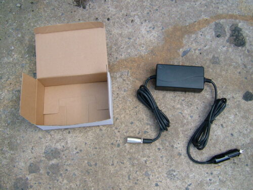

You can buy a 12v to 24 v plug in charger that plugs into 12 volt socket but very low amps ,not sure if they work on lithium, I noticed Lee was charging Linda's scooter off grid ,
I've considered this, so I'll chat to Lee and see how it is. This is the one I found on eBay
word to note for anyone looking at this ....
The connector on that looks very similar to my eBike Battery Charger (except mine is 48V 2A). I had a look at mine to compare and there are 5 different combinations noted of the pinouts on those 3-pin connectors.
so DO NOT assume the +ve and -ve of the connector matches the pinout of your battery charger port!!
What did you find that wasn't pin 1 +ve, 3 -ve and 2 ground/inhibit mate?
.Check example top middle against example bottom left for the 3-pin versions. + and - are reversed.
There is a different key for the two so if that is a universal standard (I don't know. I actually doubt it as it would make more sense to have a standard on the pins if they are going to standardise anything), it should be hard to make the plug fit but if someone pushes hard enough .....
Ok, cheers. Yea, that keyway in the different place should make it impossible to screw up.
I asked because I'm considering it for boy's chair, thanks for the info.
