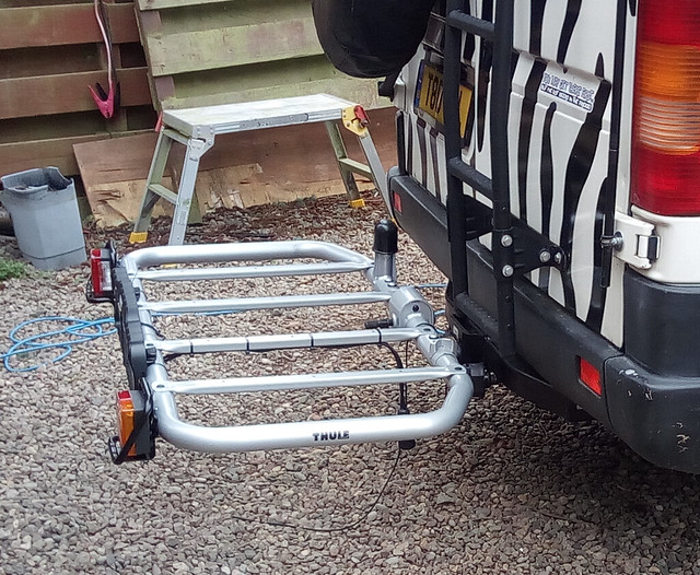

It wasn't suitable as Thule intended though, so first step after putting the base together was remove the right hand upright support where it fouled the door mounted Ladder
Base offered up and upright cut down
by David, on Flickr
(I also adjusted the ladder position to make it higher so it cleared the main base part)
The upright pole as shown in the first [Thule] photo I wouldn't have fitted anyway as it would have also fouled on the Spare Wheel on the left hand side.

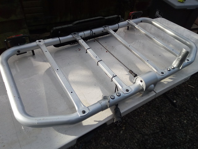

On the bench and this is what we have
Thule Carrier
by David, on Flickr

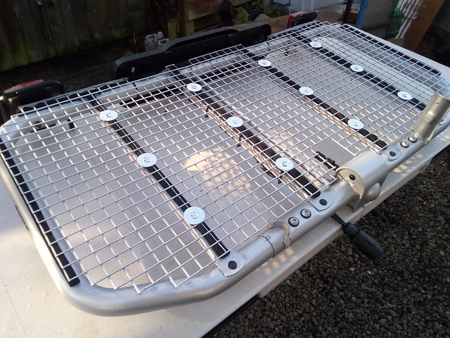

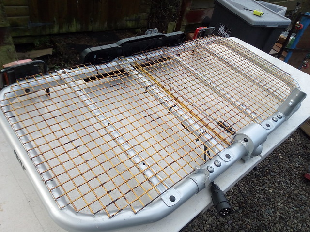

Took some mesh I had hanging around and cut it to match the Easy Base platform
Thule Carrier - Mesh Offered Up
by David, on Flickr
(Thule do sell an "EasyBasket", but that costs around £100 or so, so quite pricey for a bit of shaped wire mesh)
Bit of wirebrushing and then some paint and primer made the mesh a lot tidier.
Then some Neoprene Foam strips put on the base to provide some anti-vibration & anti-rattle support for the mesh; Then bolted it down using Roofing Bolts with Penny Washers at the top and standard washers and Nylock nuts underneath.

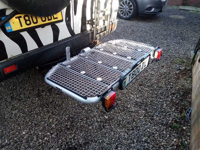

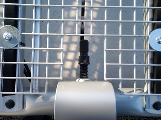

Strategic trimming in the mesh was added to allow access to the towbar securing bolt
Mesh Cutout
by David, on Flickr
And fitted into place ready for use
Thule Carrier with Mesh
by David, on Flickr
I need the numberplate (and will put a yellow one on) as when in use the door mounted plate will be obscured, but not sure if I need the lights though? the standard lights will still be visible, but the carrier is 700mm further back from those lights which may be too far?

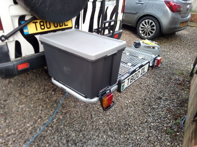

Adding some of the extra bits to the Carrier ....
Storage Box
by David, on Flickr

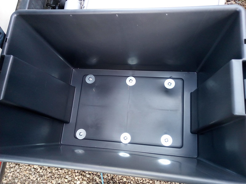

This is a fairly heavy duty box that came from Home Bargains at the princely sum of £12.99. I secured it to the Carrier using the same type of bolts and washers I used for the mesh
Box Bolts
by David, on Flickr

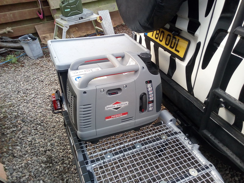

Adjacent to the storage box I have a place for other items and specifically, depending on the occasion, my Generator
Briggs & Stratton P2200
by David, on Flickr
(I am going to look for a base for this to rest on and will be secured with straps plus a chain for security)
The Box bolt-down location was specifically selected to allow the generator to be put adjacent to it and still allow the right hand rear door to open to allow access to the main garage storage
I can run the generator while it is on the Carrier and there is no vibration carried though to the Campervan.
