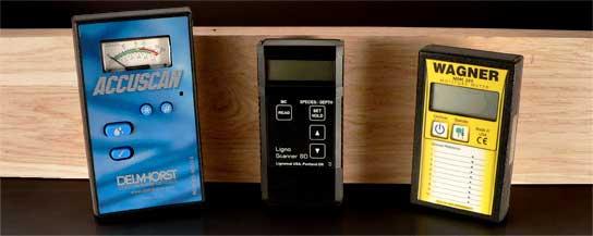

Does the internal temperature of your motorhome effect a damp meter?
Hi and welcome to the forum.
Good question, I would guess that a cold surface may feel damp to the touch, but a damp meter just sends out a measured current and displays a figure or precentage I would say a warmer temp might give a different result.
Google says yes
I think most of us have a meter, I tend to check mine on a known surface, such as a dry piece of wood that has acclimatised in the van, and then compare to that, needs to be a soft wood as what you are checking in the van is likely just a plywood behind a veneer of vinyl, ensure it is set to wood and not brick etc.
Thanks both.
Van is sat on drive not been used for a month so that explains why % higher than normal (y)
