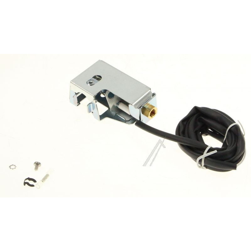

Some electrical / technical knowledge required here please. Last week, I decided to clean the fridge burner. So, got to the burner, took it out and emptied all the fine dust out of it, then thought I’d gently clean the top of the burner, and it started collapsing as I touched it. I suspect 5 years of rust and heat had weakened it. Anyway, I managed to effect a temp repair and ordered a new burner assembly, which came today. It seems easy to fit, apart from the igniter and thermocouple wires that plug into a module, on the back of the fridge that is impossible to get to without removing the fridge, which I don’t fancy doing. So, I have 3 choices. Leave as it is, but it will corrode more. Try to renew just the burner, but I think this is soldered in. Cut then rejoin the wires to the new module.
The wires appear to be single stranded steel. Is it safe to cut and rejoin these? Will it work?

thanks, it is that burner, but I bought mine for €82 ( we live in France. ). I decided not to cut the wires. I took the fridge halfway out. It’s simple, 4 screws and the gas connection, so, it’s all done now.
Pictures are original burner with temp Heinz baked beans lid repair ( it worked fine!) Damaged burner before temp repair, and new burner in place. Took about an hour from start to finish.

Hi. Just wondering whether anyone has managed to source just the burner tube. Dometic do just the tube for some models but seem to want to take nearly £100 from us for what must be a £5 part
That was all I wanted really. The tube is held in by 2 steel tabs, easy to remove and refit, so it’s difficult to believe it can’t be sold seperately. But, the whole burner assembly comes with a new jet too, I paid €82 inc delivery. That’s around 70 GBp. Difficult to fit though.
