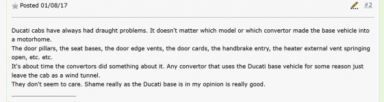

Try where the seat belts fit in the bottom of the pillar (the inertia reel) that's where my draught was coming from (y)

Yes and I haven't found them all yet :( There's alot of people on the Fiat Forum complaining and I've checked most out but still feel a draught in the cab. Another one I found was from the door speaker grilles, my Hymer doesn't have speakers in the doors so I used some bubble wrap and duct tape to seal them up.
