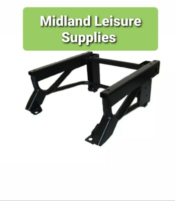

Surely most issues could be sorted with a lowered seat base, how hard could that be to do?
That’s my point in post #6 but I’d either lose the swivel component or it would entail major reworking, other MHs like mine may also house electrical equipment beneath the swivel mechanism. I’d like to hear of any suitable optionsSurely most issues could be sorted with a lowered seat base, how hard could that be to do?
£120 seems quite reasonable, Kev, given that Dometic want £36.11 for the plastic clip that holds the fridge door open when powered down; or £67+ if you need the metal latch plus plastic clip ...PHEW!!
Pricey
Peugeot Boxer Citroen Relay Fiat Ducato 07-21 Single Seat Base | eBay
Find many great new & used options and get the best deals for Peugeot Boxer Citroen Relay Fiat Ducato 07-21 Single Seat Base at the best online prices at eBay! Free delivery for many products!www.ebay.co.uk
Might be a bit OTT for most peopleget a coach built, no problems with mine except they put the battery under the seat and the seat is very heavy. Both my son and son in law (both builders) have a job lifting it in the restricted location and for me at 80 it is nearly impossible.
On the VW Transporters, it is fairly common to cut off a part of the seat base to lower it in order to counteract for the increased height of the swivel plates. If you have (or know) a welder, it is very easy to do as just a matter of slicing off the bottom couple of inches and then welding some plates to replace the mounting bolt plates that you ended up cutting off. You cut the bottom off, not the top and so the seat mounts just as before.Surely most issues could be sorted with a lowered seat base, how hard could that be to do?
