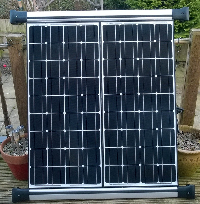

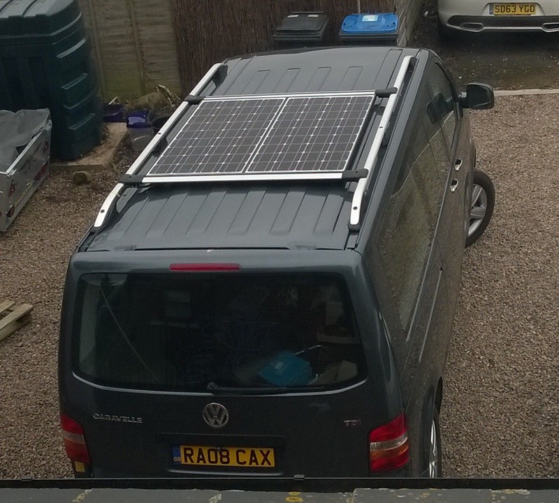

I was wondering if a method I used on my T5 would work for you?
Fitted a pair of panels to cross bars using Rivnuts
image_1
by David, on Flickr
And the crossbars then simply clamped to the Roof Rails
image_6
by David, on Flickr
